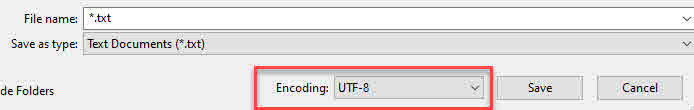

    Posted Oct 14, 2019 06:42 AM
    Open the file in for example notepad, then make sure to save it in UTF-8 format.
  • 21.  RE: scheduling_task
    Posted Oct 28, 2019 02:23 PM
    hi luc ,
    was on leave .however scheduled task to run this script is working now .
    thanks.
