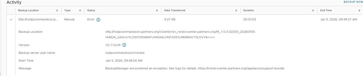

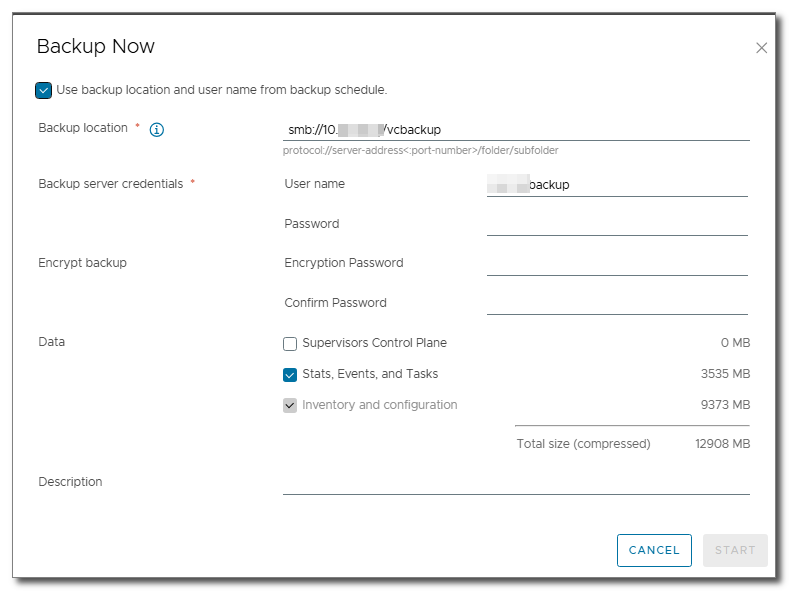

    I am going through the motions of setting up the backups for the vCenter servers in our clusters. I have a destination
    system in place, and I have confirmed FTP, SFTP, and SMB are available for this purpose.
    However, whenever I do an interactive backup, the following error condition occurs on both vcenter systems:
