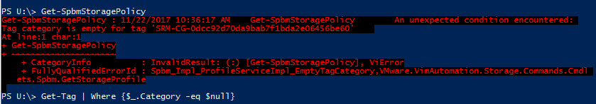

    When I run the following from PowerCli 6.5.1 :
    Get-SpbmStoragePolicy -Namespace "Bronze Datastore Policy"
    Or Just Get-SpbmStoragePolicy
    I get Object reference not set to an instance of an object

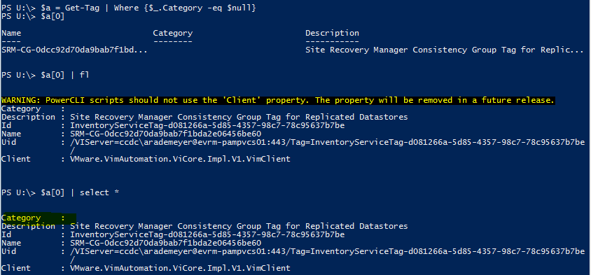

    I did  Get-Tag | Where {$_.Category -eq $null}
    It returned quite a few uncategorized SRM-CG and SRM-PG ones .
    I am however pretty sure I cannot delete or edit those , from names , they were clearly created by system : EG
    Name                           Category                       Description
    SRM-CG-341213cf07293d273f81...                                Site Recovery Manager Consistency Group Tag for Replica...
    SRM-PG-939d00673c75ea9c7a47...                                Site Recovery Manager Protection Group Tag for Protecte...

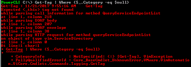

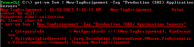

    I did notice SOMETIMES when I run a tag command from a version of PowerCLI of 6.5 or 6.1 my tag commands error out with the following:
    Tag's used to work when we were on vCSA 6.0 but as soon as I updated to 6.5U1 (was only trying this once we finished upgrade) it all stopped working...
    I've tried this on multiple machines, w/ different versions of PowerCLI and it seems to be consistent in the fact that it just no longer works...

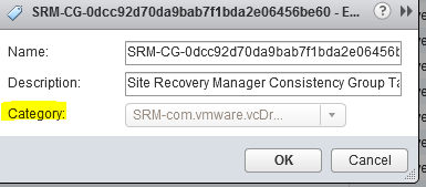

    From my humble point of view it does look like its related to SRM auto Tags not returning a category .
    Funny thing is , in the web client there is a built in category not shown via PowerShell .

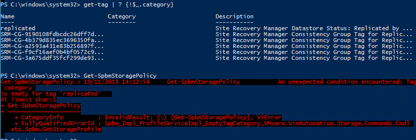

    Hello,
    I'm seeing the same error - did you figure this one out?
    I've tried PowerCLI 6.5 and now 11:
    PowerCLI Version
       VMware PowerCLI 11.0.0 build 10380590
    Component Versions
       VMware Cis Core PowerCLI Component PowerCLI Component 11.0 build 10335701
       VMware VimAutomation VICore Commands PowerCLI Component PowerCLI Component 11.0 build 10336080
       VMware VimAutomation Storage PowerCLI Component PowerCLI Component 11.0 build 10380343
    Thanks,
    Jon
