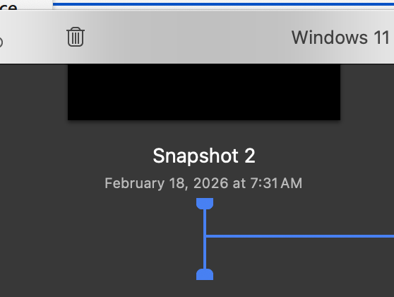

    I used the delete snapshot option below(clicking on the garbage can after highlighting old snapshots I want to delete). I noticed the one I deleted took a bit longer to delete than others before the dependency error came up. You figure VMWare would do a better job letting us know if a snapshot depended on another before you had an option to delete it. Logs are attached. Any help is appreciated!

    I don't think so as I have around 80 GB in free space so should be good there. Lesson to be learned is be careful when deleting snapshots. No warning from VMWare Fusion if there are dependencies on older snapshots which seems to be the case here. They should not allow you to proceed with a snapshot delete if there are dependencies. Good idea for a request for product enhancement.

    Posted Mar 03, 2026 01:31 PM
