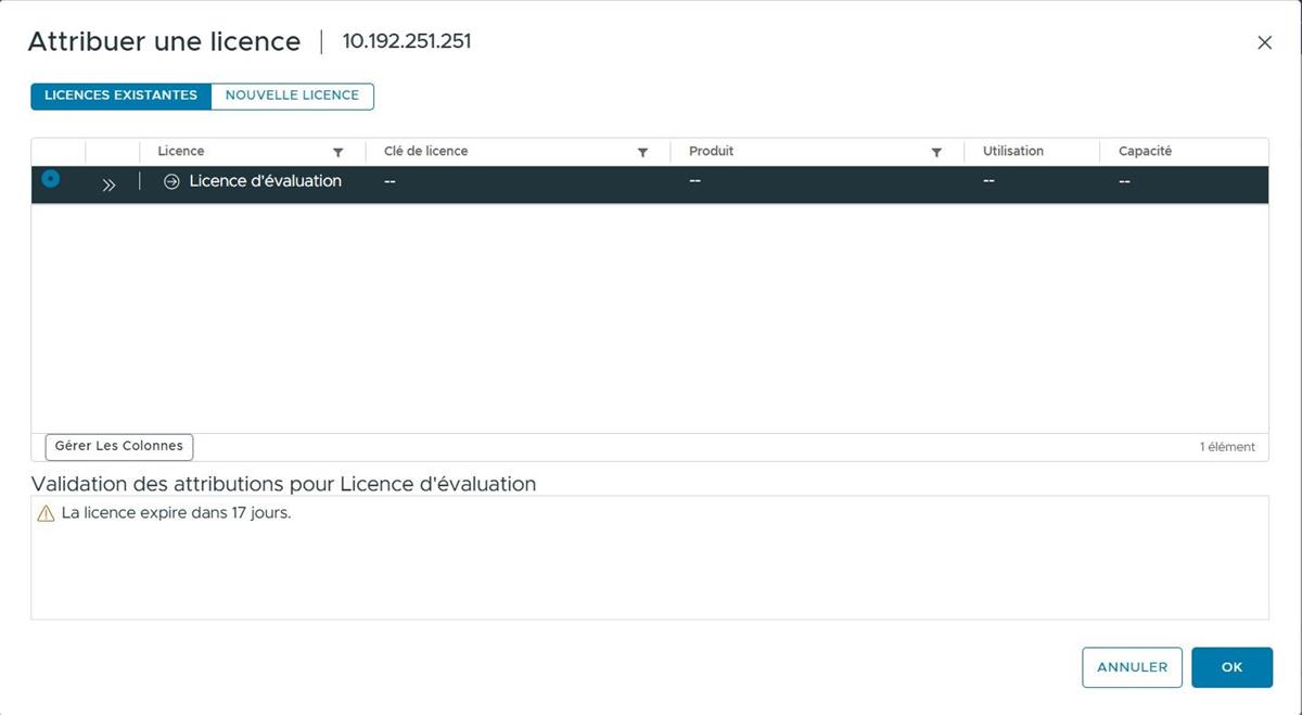

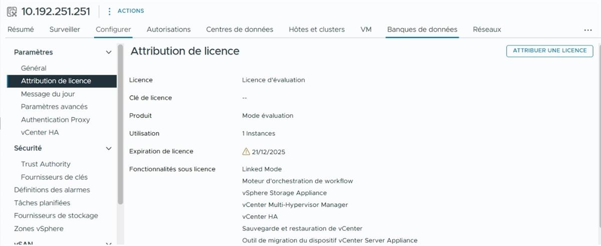

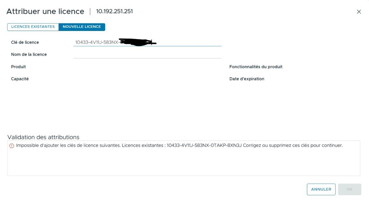

  • 8.  RE: Licensing Mode evaluation to perpetual License (subscription License)
    Broadcom Employee
    Posted Dec 08, 2025 12:13 PM
    If you post an image of the Licenses screen that lists all your licenses (please mask part of your license keys in the image so you are not publishing them to the world), I will see if I can figure out why the key for which you are looking is not appearing in the assignment dialog.  If your licenses are under support, I suggest opening a support case.
