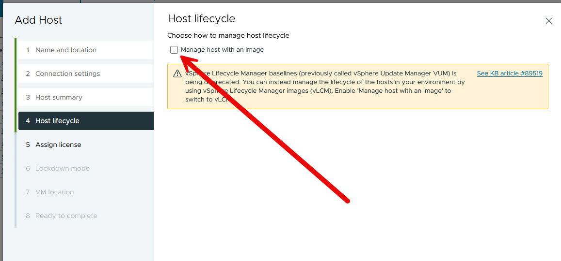

    Can you try to remove the Standalone ESXi cluster from the vCenter and reconnect it?

    like you suggest: i removed the Standalone ESXi  from the vCenter and reconnect it without the option for image.
