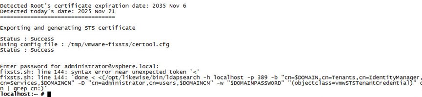

    How to renew the STS certificate? The VCSA version is 6.0.
    I have tried two methods but neither worked. Does anyone have a good solution?
    The first method: the fixsts.shscript mentioned in the official KB, but it failed to run because my VCSA version is 6.0, which does not support this script. The error is as follows:
