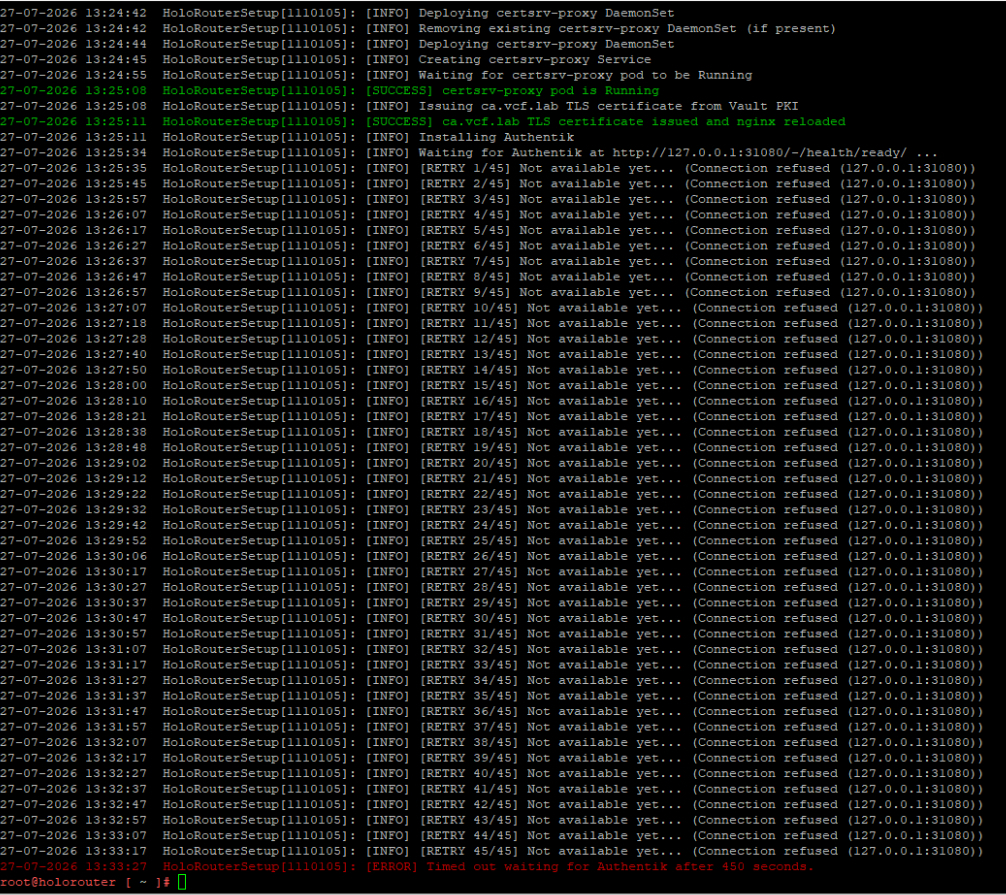

    Deployment then reaches:
    Installing Authentik
    and waits for readiness:
    Waiting for Authentik at
    http://127.0.0.1:31080/-/health/ready/
    The installer performs all 45 retries:
    [RETRY 1/45]
    [RETRY 45/45]
    and eventually fails with:
    [ERROR] Timed out waiting for Authentik after 450 seconds.
    A screenshot of this stage is attached.
