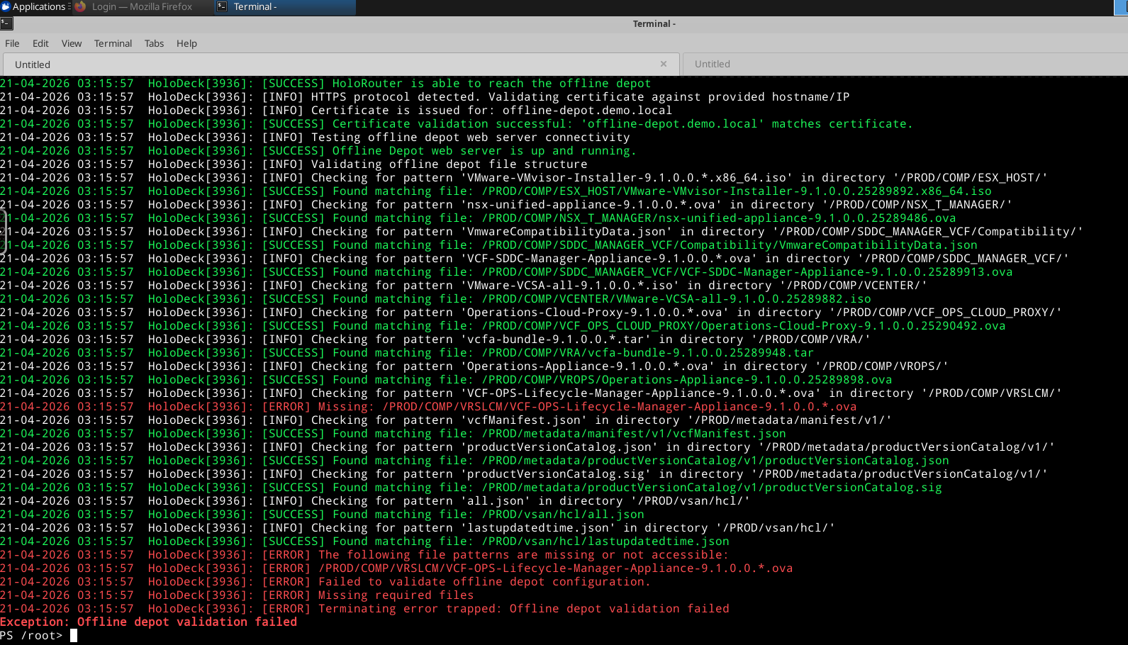

    I would like to seek your advice regarding the VCF 9.1 offline depot downloaded from the Broadcom support portal.
    After pointing to the offline depot, the system is unable to locate the Lifecycle Manager files. Do you have any idea where I can obtain the required OVA?

    As a workaround, create the following OVA file under /VCF91/PROD/COMP/VRSLCM/:
    VCF-OPS-Lifecycle-Manager-Appliance-9.1.0.0.24695812.ova
    You can do this by copying the existing 9.0.2 OVA and renaming it:
    cp VCF-OPS-Lifecycle-Manager-Appliance-9.0.2.0.25137839.ova \

    I'm unable to locate the VCF-OPS-Lifecycle-Manager-Appliance-9.0.2.0.25137839.ova in the offline depot or on the Holodeck router.
    Is there a way to download this file, or is it possible to proceed without it?

    As a workaround, you could try to only create empty file:
    touch VCF-OPS-Lifecycle-Manager-Appliance-9.1.0.0.24695812.ova

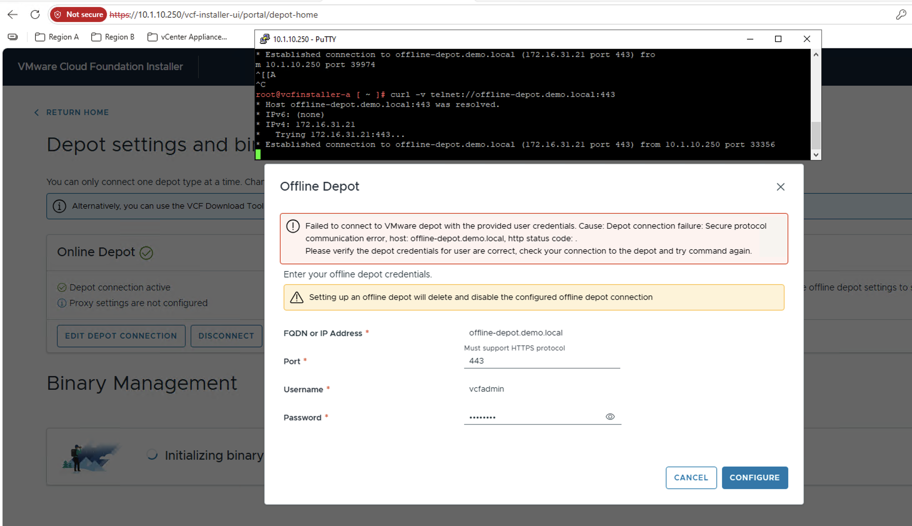

    However, I'm now encountering another issue. When I try to connect to the offline depot server, an error appears (see below).
    I have verified that the credentials are correct and that HTTPS access works via the web browser. Do you have any idea what might be causing this issue?
    Thank you for your assistance.

    I used http without username/password. Could you try offline depot with http?
    Enter offline depot IP/FQDN: x.x.x.x
    Enter offline depot port: 80
    Enter offline depot protocol (http/https): http
    Enter offline depot username:
    Enter offline depot password:

    Just for your information, to use the offline depot over port 443 in the VCF Installer, the certificate needs to be trusted via the CLI before adding it in the UI. It seems this may be a limitation from v9.0 to v9.1.

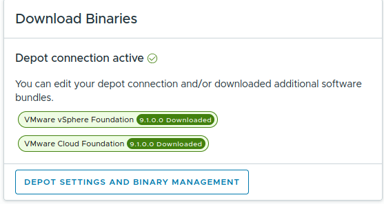

    I'm happy to share that I've successfully deployed VCF 9.1 in Holodeck.
