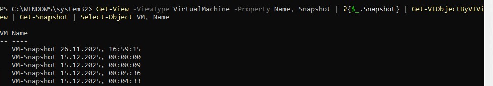

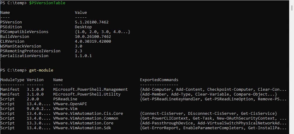

I had downgrade VIM to the same version like on the old server (2022).
But it doesn't work too. What ever it is :-(

Original Message:
Sent: Jan 07, 2026 03:55 AM
From: rkabelich
Subject: Get-VM | Snapshots | VM, Name -> missing VM-name
Okay, then I'm stumped. Your versions are newer than ours and it does not work.
PS U:\> $PSVersionTable
Name Value
PSVersion 5.1.20348.4294
PSEdition Desktop
PSCompatibleVersions {1.0, 2.0, 3.0, 4.0...}
BuildVersion 10.0.20348.4294
CLRVersion 4.0.30319.42000
WSManStackVersion 3.0
PSRemotingProtocolVersion 2.3
SerializationVersion 1.1.0.1
PS U:\> get-module | ft -AutoSize
ModuleType Version Name
Manifest 3.1.0.0 Microsoft.PowerShell.Management
Manifest 3.0.0.0 Microsoft.PowerShell.Security
Manifest 3.1.0.0 Microsoft.PowerShell.Utility
Manifest 3.0.0.0 Microsoft.WSMan.Management
Script 0.0 onecli_completion
Script 2.0.0 PSReadline
Script 7.0.3.18730922 VMware.Vim
Script 12.4.0.18627057 VMware.VimAutomation.Cis.Core
Script 12.4.0.18627061 VMware.VimAutomation.Common
Script 12.4.0.18627056 VMware.VimAutomation.Core
Script 12.4.0.18627054 VMware.VimAutomation.Sdk
May be it's a bug. I hope somebody else has a hint, I'm out of ideas. :-/

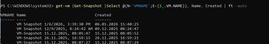

Original Message:
Sent: Jan 07, 2026 12:46 AM
From: ganapa2000
Hi Dennis,
Try as below
Get-VM | Get-Snapshot | Select @{N='VMName';E={$_.VM.Name}}, Name, Created | ft -auto

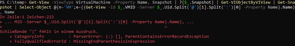

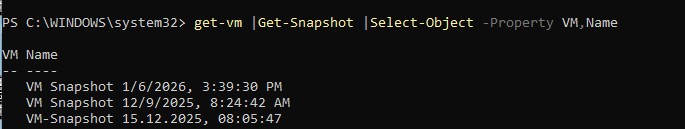

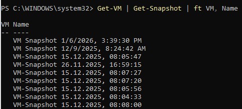

Original Message:
Sent: Jan 06, 2026 10:29 AM
From: SirHaschke
Hi,
Get-VM | Snapshots | VM, Name i get this output.
Why is the VM-Name missing?
Regards
Dennis
