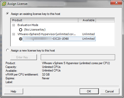

ItfascinMar 19, 2012 03:14 PM
  • 1.  ESXi 5 update1 forces hard RAM limit on free version?
    Posted Mar 16, 2012 03:41 PM
    I installed update1 on a ESXi 5.0 box running the Free Hypervisor,  and it was licensed with a free license that limits vRAM to 32GB,  and now that license is no longer valid.   It says because the system actually has more than 32GB of physical RAM it will not be allowed.  Is this a planned change?    I didn't see anything mentioned in the Release notes.

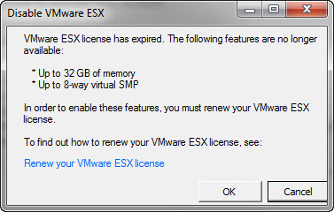

    Exact same issue here after installing update 1.
    Had 64GB memory, licensed for 32GB standard edition was installed, (so was only using 32GB), now wont start as says license expired.
    When you try to enter the license back in you get:  "Error occurred when assigning the specified license key: The system Memory is not satisfied with the 32 GB of Maximum Memory limit."
    Had to pull out 32GB for now to get things going. Would like to keep the physical memory installed as may upgrade to enterprise edition down the road.

    I did a fresh install of ESXi 5 U1, downloaded the media from the Enterprise link within the vSphere section as the regular ESXi Hypervisor download does not show ESXi 5 U1.
    I receive the following error upon trying to insert the license:
    So I did a fresh install of ESXi 5 (version 469512) and was able to set the license key properly and the system works just fine.
    Performed an upgrade to ESXi 5 U1 and am instantly greeted with a license expiration notice:
    So am I taking it correctly, that I need to physically remove RAM to make the system function properly?
    Or am I just being impatient in wanting to upgrade my test box to ESXi 5 U1?
    Thanks.
