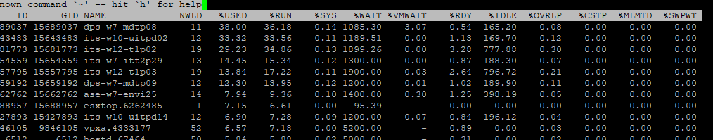

    I have blades that have 2 cpus with 6 cores a piece, for the most part I have cpu ready times under 1%, but a few 8 vCPU servers are showing 2-3%
    These are Terminal Servers in a horizon view enviornment and I'm trying to keep them under 5%, which from what I've read is when users start seeing issues. The other vms are all 2 vCPU, is it just the extra 6 vCPU being added causing the 2% increase, or is it the fact that I crossed over to the second cpu? These were 4 vCPU and I was having 100% cpu spikes on logon so they needed to be increased.

    I probably wouldn't worry too much about 2-3% (10% is where you should start looking at ready time) and you have Co-Stop at 0.  Other than the VM showing 100% spikes were there performance issues?  After adding resources do you still have any performance issues?  It sounds like you are going over the NUMA boundry of 6 cores so for performance you might have issues with would be memory based rather than CPU.

    A large group logs on once a week so I'm waiting to see if the cpu spike goes away. The horizon rdsh servers if your not aware let you provide just the application virtually instead of an entire desktop. In the metrics I see the requested apps taking 8-10 minute to open, and the cpu spike was longer than that and covered that time. I'm not worried about the 2% right now, I'm more curious why those are 2-3% and the other ones are 0.1%. I'm trying to figure out if its worth it to try 6 vCPU vs 8 vCPU, the 6 would be all on one processor. This enviornment is most likely going to expand quickly from where it is so I have to keep a very close eye on performance so I can make sure we get new hardware if we need it as soon as we determine its necessary.

    Well 5ms of disk latency could certainly impact CPU as well. However, when you have 2-3 %RDY I would not be worried, for the number of VMs and vCPUs you are running that is relatively low. Note that when you have 8 vCPUs you have to divide 3% by 8, and then you have the per vCPU %RDY, which is extremely low in your case.
