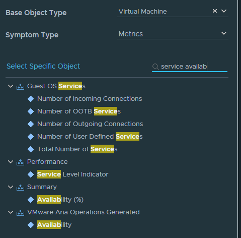

  • 3.  RE: Customize aria service alert
    Posted 11 days ago
    I found this in the Symptom Definition. It looks like there is a condition we can use when the service becomes unavailable? not specifically when the service is down.
