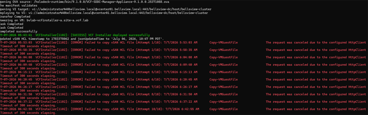

    The deployment continues after I make this temporary configuration change.  However, the deployment fails after the VCF Installer is deployed see attached image
    Has anyone else send this issue when deploying VCF 9.1 with HoloDeck.
