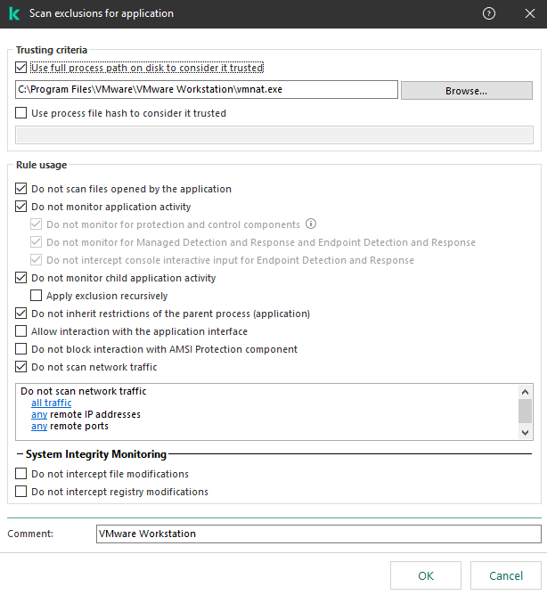

    When I mentioned the network traffic exclusion, I didn't just add a simple firewall rule. I configured it under the deep "Trusted applications" (Exclusions) policy.
    Here is a screenshot from KES Policy / General Settings / Exclusions / Trusted applications:
    I didn't investigate it any further, but this is what works for me.

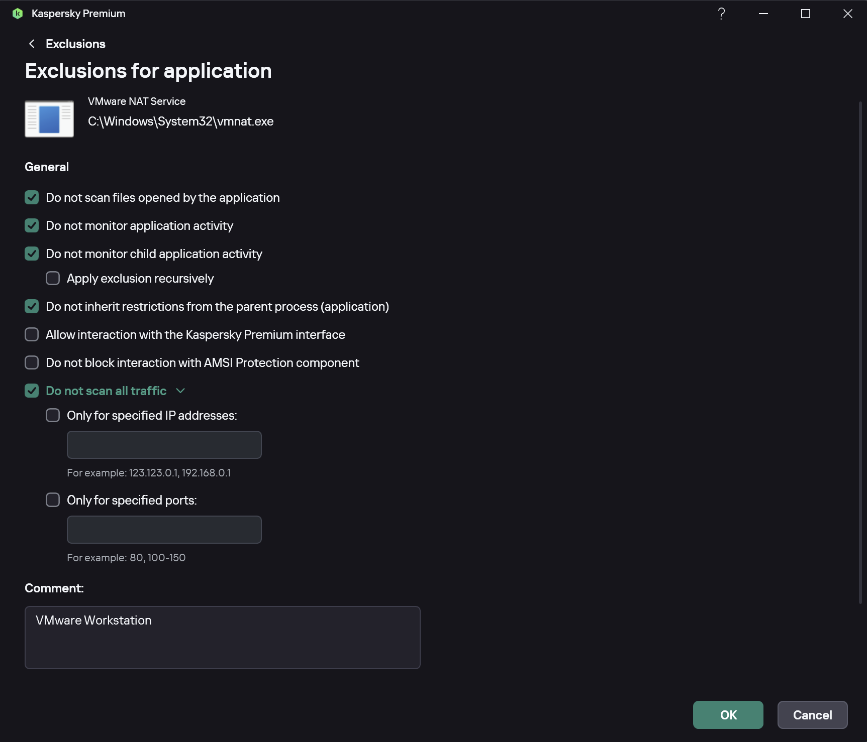

    I've now reproduced your Trusted Applications setup as closely as possible in Kaspersky Premium. I understand you're using Kaspersky Endpoint Security, so the interface is slightly different, but Premium provides equivalent options for the settings shown in your screenshot. I enabled the same exclusions for vmnat.exe, and I'm attaching a screenshot of my configuration so you can compare it with yours.
    Unfortunately, it still didn't solve the issue on my system.
    I switched the VM back to NAT and initially everything worked normally: Internet connectivity, the VMnet8 host adapter (192.168.108.1) and the NAT gateway (192.168.108.2) all responded correctly. I then started a continuous ping to 192.168.108.2.
    After a few minutes, the NAT gateway became unreachable again.
    Interestingly, VMware NAT Service was still reported as Running, but vmnat.exe had entered the same CPU busy-loop as before: approximately 10 CPU seconds during a 10-second measurement, effectively consuming one logical CPU core.
    Windows also logged two new vmnat.exe APPCRASH events:
    • 19:50:46 - vmnat.exe 26.0.1.2799 - exception 0xc0000005 - fault offset 0x10c23
    • 19:52:46 - vmnat.exe 26.0.1.2799 - exception 0xc0000005 - fault offset 0x10c23
    So unfortunately, the workaround that works with Kaspersky Endpoint Security doesn't appear to resolve the issue in my Kaspersky Premium environment.
