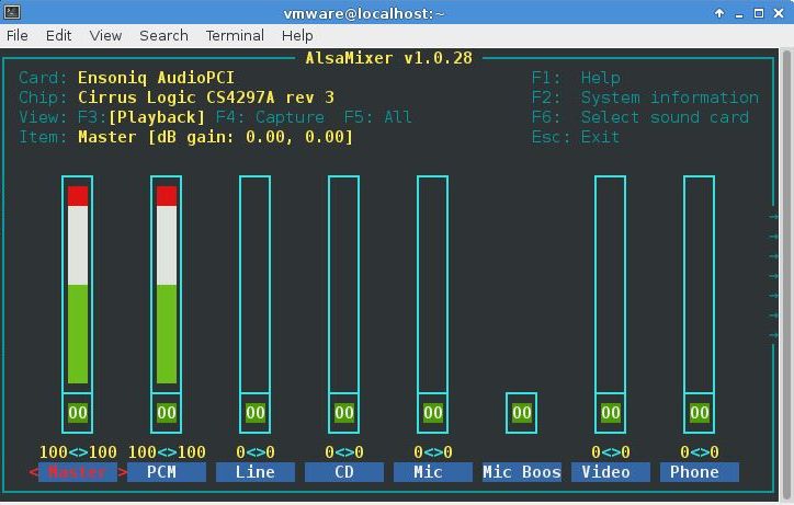

    I have installed (browser-appliance feb 8,2012) and everything is working fine except for the sound.
    There is almost no sound.
    sudo system-config-soundcard does not exist in SL 6.0
    Upper right corner: Soundcard  150 %,  10dB,  dummy output
    Lower right corner:  Soundcard-> Settings:  Device status connected and connect at power on marked
    specify host sound card: Speakers (connexant HD audio).
    Speaker output works fine in host OS (Win7),
    latest version of VMware player (4.02-591240)
    vmware-toolbox output:  version 8.8.0-471268 (450511 19/7/2011) which seems to belong to vmplayer 4.0  !!!   ???
    vmware tools for vmware player 4.0.2 does not seem to be availabe yet. I will try to update vmware tools with the packages for 4.0.1 to see if that makes any change.
    (see also http://communities.vmware.com/message/1988653#1988653 )
  • 22.  RE: Browser Appliance
    Posted Feb 14, 2012 08:58 PM
    Virthein,
    I'm not sure what is causing your sound issue, since it works fine for me:
    - Host OS is Windows XP,
    - Latest version of VMware player (4.02-591240)
    - VMware Tools version 8.3.12-559003 (provided by the Browser Appliance 10.0).
    Here are my VMware player settings:
    - Upper right corner: Soundcard 100% (instead of the default 3%), 0 dB, "Internal Audio Analog Stereo"
    - Lower right corner: Soundcard-Settings: Device status "Connected" marked (was not by default) and "Connect at power on" marked; "Use default host sound card" selected. Host sound card is "Microsoft RDP Audio Driver".
    Where does your vmware-toolbox output come from?
  • 23.  RE: Browser Appliance
    Posted Feb 15, 2012 01:37 PM
    Hi Christophe,
    My Dummy mistake....  Upper right corner: Dummy output !!!!
    Changed it to Internal Audio Analog Stereo output and it works like a gem.
    ps.
    vmware-toolbox is a console command which opens in X.
    Also no need to upgrade vmware tools .

  • 64.  RE: Browser Appliance
    Posted Jan 11, 2016 02:38 AM
    I also did not hear any sound.  I am a long time user of the Browser Appliance and wished to upgrade to the latest release, so I spent some time comparing the setup to the previous release (Firefox ESR 24.0, CentOS 6.4). It seems to me that the ALSA volumes in the latest release (Firefox ESR 38.3, CentOS 7.1) are set too low. You can see the volume settings if you type the following in a command-line interface terminal:
        alsamixer --card 0
    Press the <Esc> key to return to the command-line interface terminal.
    To set the volumes to their maximum (which was the setting in the previous Browser Appliance) type the following  in a command-line interface terminal:
        amixer -c 0 sset 'Master' 100%,100%
        amixer -c 0 sset 'PCM' 100%,100%
    Type “exit” (without the quotation marks) to close the terminal.
    Use the Alsamixer command again to verify the change.
    That “turned the sound on” for me, so I hope it helps others as well.
