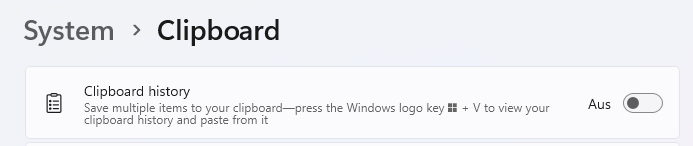

    Posted Jan 15, 2026 09:06 AM
    I did some testing, and it looks like I had enabled the Windows 11 clipboard history. I disabled it and restarted the VM. It seems to have fixed the issue. Disable it to test.
  • 7.  RE: 25H2 Copy/paste works at first, then stops
    Posted Jan 15, 2026 09:36 PM
    Unfortunately, this tip didn't solve the problem. Or rather, "Clipboard history" hadn't been activated before.
    Well, then I followed your approach in meet the issue. I enabled the  "Clipboard history" and restarted the host, then I disabled the  "Clipboard history" and restarted the host again. The problem still persists.

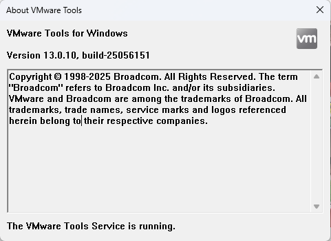

    I have upgraded the VMware tools for windows to version 13.0.10-25056151.
    You can confidently abstain from installing it. It doesn't resolve the problem.
    The copy/paste function doesn't work right after the tool is fresh installed. Tested it 2 times (2 reboots).
