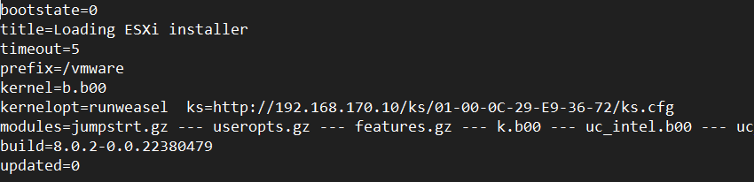

    And the content of the cfg file is :
    Any idea, advice ?
