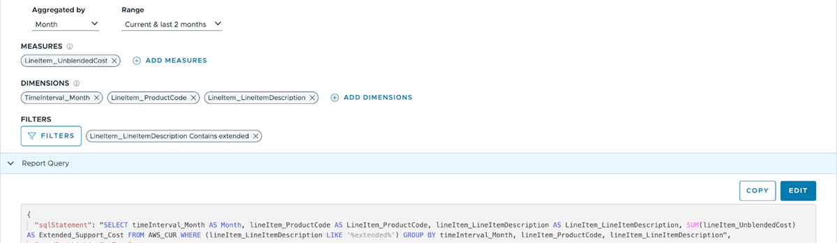

  3. Now, using the Report Query Editor:
    • In the Classic experience, first remove all existing text (including brackets), copy the query below, then hit Apply
    • In the New Experience, switch from UI to SQL Query, then remove existing text (including brackets), copy the query below, then hit Next. You will then need to add a Report Name, Description, as well as adding labels and other settings.

  4. While the above queries are generic, they serve as a good starting point to make the report your own.
    If you have perspectives configured, choosing perspectives that will help make engineering conversations easier is critical.
    Loading the query will load report configurations automatically - you can add perspectives like Account Owner ID, Resource tags, Team identifiers, depending on what you have configured. You can also add filters for Business Units, Teams or Accounts, to make the scope of this data smaller:

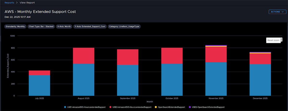

  5. The above steps will load line items that are associated with AWS Extended Support relevant to your use case.
    • In the Classic Experience, use the “Chart preview” feature to visualize your data.
    • In the New Experience, click “Preview Report” to visualize your data

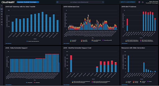

Another good way to create awareness is the creation of a Dashboard. In the New CloudHealth Experience, FlexReports can be embedded into a custom Dashboard and shared with users across the organization. In the example below, we have a custom AWS Dashboard showing 2 widgets displaying Extended Support charges. Being able to embed these reports into a dashboard empowers and educates teams on the impact of Extended Support charges and encourages them to take action.
