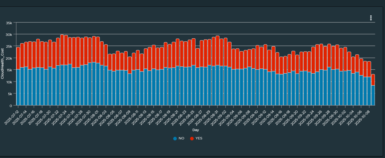

Image 1: The breakdown of Savings Plans floating vs not floating

Float: Will contain “Yes” or “No”.
If “Yes”, the cost/usage floated in from an account other than the usage account.
If “No” the cost/usage did not float (i.e. the Savings Plan was used in the same account that purchased it).
These columns allow you to trace benefits from the purchasing account to the consuming account, helping you understand where the benefit is coming from.
