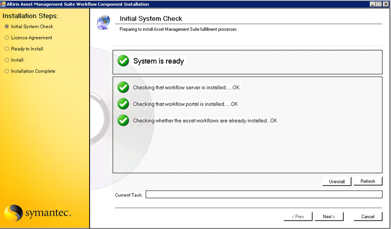

Setup will launch and the pre-requisite check starts
A couple of things to point out here:
  1. You must have workflow installed and setup first
  2. Workflow portal must be installed
If none of these items are installed or configured the installation will fail. NOTE: The first time I ran the install, I did not have the process manager installed and ran into a problem when I exited the installation, installed Process Manager and retried the workflow installation.
