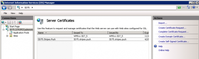

  1. Open IIS on the Servicedesk server.
  2. Double-click on the server name.
  3. Under the IIS subsection, find and double -click the "Server Certificates" icon.
  4. On the right-side, click "Complete Certificate Request", answer the questions correctly(including providing the correct "friendly name"), and you will have your certificate associated with the Servicedesk server. You then have completed the certificate server steps.
