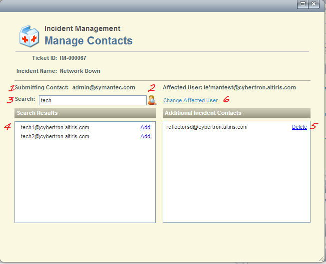

Let's go over the main parts of the Manage Contacts form:
  1. Displays the information for the Submitting user. This information can't be changed.
  2. Shows the current affected user.
  3. Text box for providing search criteria.
  4. Shows the search results based on the search criteria and the option to add a found user as a contact. Please note that users who are already contacts on the incident (Submitting, Affected, or additional contact) are filtered out of the search results.
  5. Displays any additional contacts on the incident and provides the ability to delete the contact.
  6. Link to change the affected user.

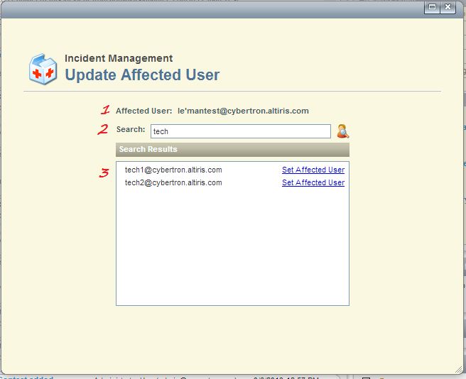

Now let's go over the main parts of the Update Affected User form:
  1. Shows the Current Affected User for the incident.
  2. Search box to enter the search criteria to find users. Note that if the search box from the Manage Contacts form contains data when clicking on Change Affected User when the Update Affected User form loads it will automatically perform the search on the specified criteria.
  3. Displays the found users based on the search criteria that you can set the Affected User to. Note that the search results will not include the information for the current Affected User.

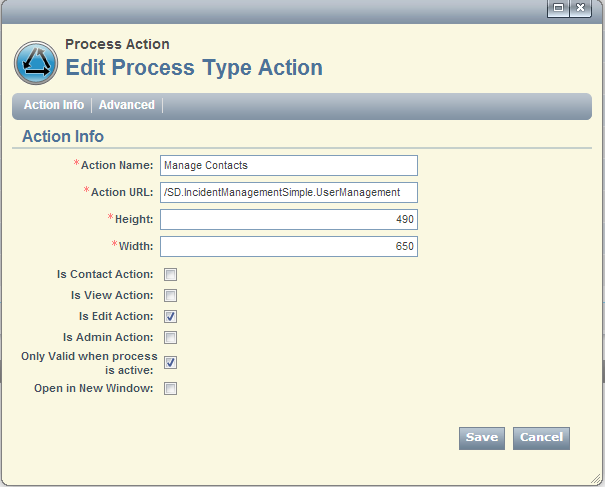

Defining the Process Type Action
  1. Go to Admin-> Data-> Process Type Actions
  2. Click the Lightning bolt for Incident Management and choose Add Action
  3. Define the new Action as the screen shot below. If you wish to provide a different name for the Action that is fine. Also the screen shot shows I've defined a privilege level of 'Is Edit Action'. This means users will need to have edit permission on the incident to modify contact information.
  1. Click Save
