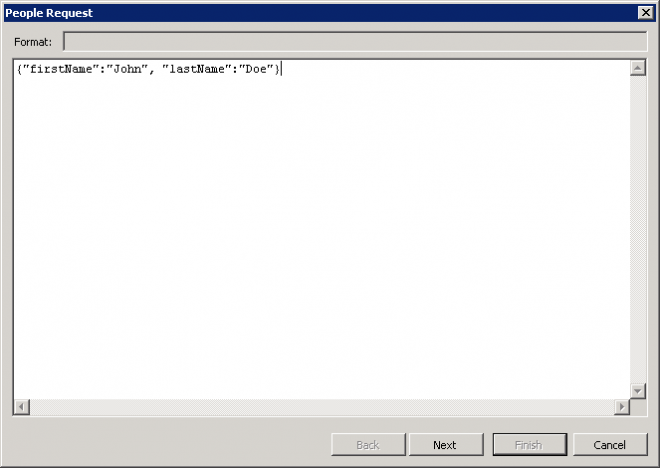

Say you have some local JSON you need to work with, the REST Generator can still be of use to turn this into an Object to work with in Workflow.
I explained about the new feature they added in a later release that allowed "Create From Sample"
A couple of things to note here, on the first page of the Generator this asks for a Namespace (Protirus), take a note of it as we will need to work with this later.
You will need to add a URL here too but it won't be used.
Grab the JSON you are wanting to work with and paste it here.

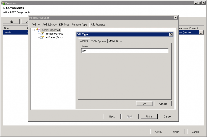

Depending on the name of your Method you will get the Data Type (DT) called this, click on Edit Type and rename if necessary.
Close and compile this.

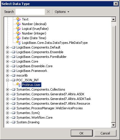

In the Workflow use an Add Data Element (LogicBase.Components.Default.Process.InsertDataComponent) and set it to your new Date Type (DT).
