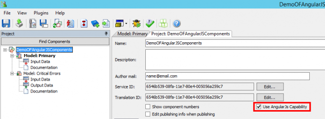

Firstly you will need to enable AngularJS in your Project.
Once you have created a new Project, go to the main  Project and tick "Use AngularJs Capability".

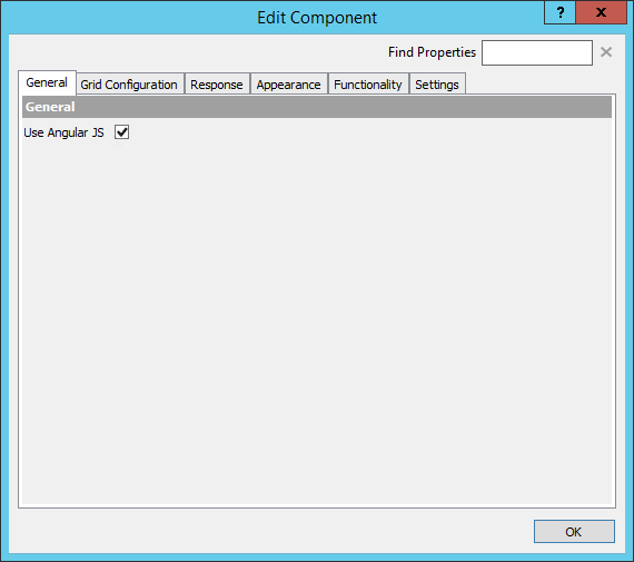

Right Click and "Edit Component".
Click on the "General" tab.
Tick "Use Angular JS".
Configure your component to get some Data then run the Project.

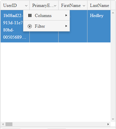

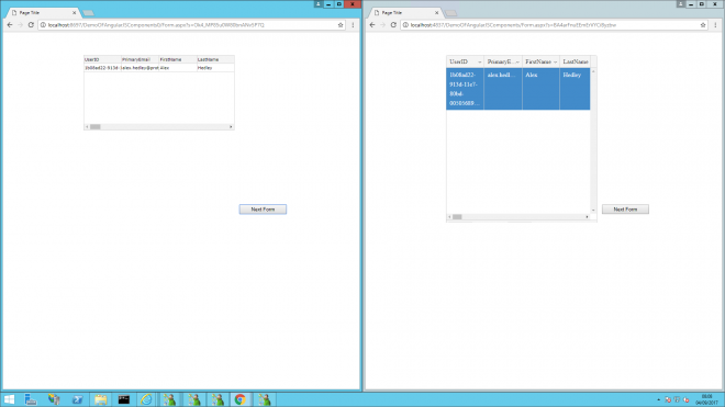

If you create a clone of the example, but turn off AngularJS and run both you will see the difference in the Grid.

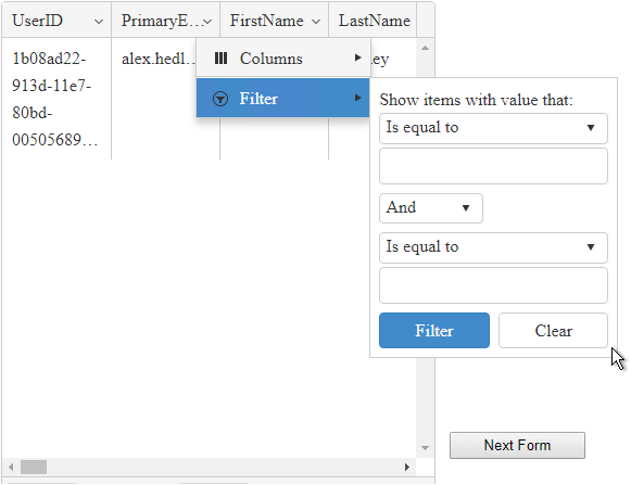

You will see there are extra options against the Column Headings.
You can Filter any row
Filter
Is equal to
Is not equal to
Starts with
Contains
Does not contain
Ends with

Alex, I have found the new angular based grid component does not follow the element sizing.  The same behaviour is visible in your example above (the angular grid is about twice as high).  Have you found a way to correct this?  I've had a couple of attempts with javascript without much success.
