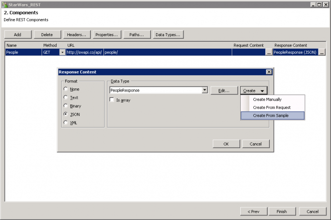

New to me with build Symantec.Workflow.Setup.7.6.4383.504 the REST Generator has been updated to generate Response Content in a third manner - "Create From Sample".
7.6.4383.479 was the first build to have this
With Response Content there were two ways to create the Data Type you need to work with.
  • Create Manually
  • Create From Request
Create Manually was a lot of work but was handy when the Generator can't authenticate against the API or you used a method that wasn't possible.
The Create From Request is the easiest as it does it all for you.
There is a new one
  • Create From Sample
Grab your JSON and paste it in, most APIs have this documented or you could run it through POSTMAN and grab the output
Hit Next
REST Generator - 2 Components - Response Content - Create from Sample - Data Type.png
There you have your DataType to work with.
This should also pull in the headers and map those, I've yet to test this out.
