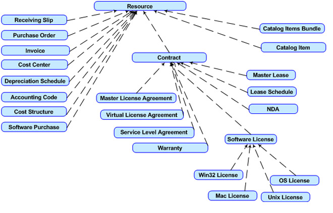

The Contract Resource Type is also derived from the base Resource type. Below is a chart of the Contract Resource.
Figure 3. - Contract Resource Type Model
