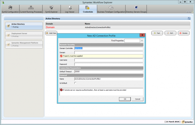

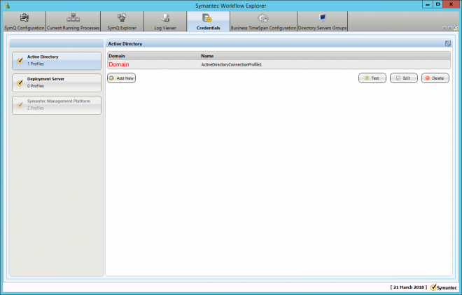

Active Directory
Click on the "Active Directory" tab.
Click on Add New and fill in the values.
You can highlight a Profile and click "Test"

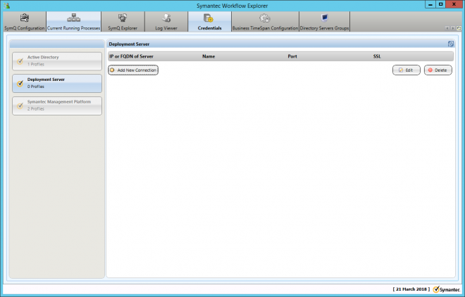

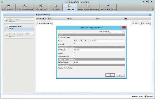

Deployment Server
Click on the "Deployment Server" tab.

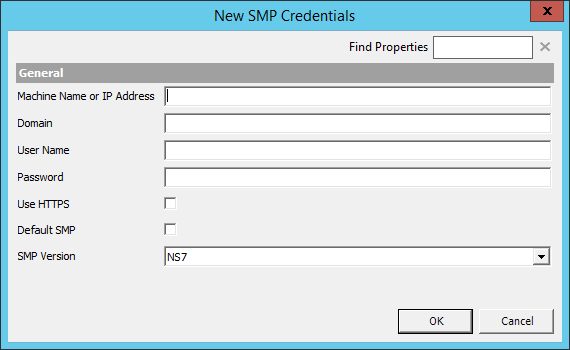

Symantec Management Platform
Click on the "Symantec Management Platform" tab.
Click on "Add" and fill in the required details.
You can also "Test" this to make sure it's valid.
