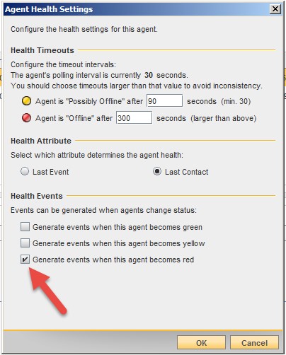

In the Assets view, highlight multiple assets, right click and choose Properties.  Be sure to include the test machine.  This will bring up the Agent Health Settings dialog window.
Note: If only one asset is chosen, the Agent Health Settings dialog window will be accessed from the Configure Health button found on the General tab.
In this window simple check boxes are displayed that enable (or, disable) events to be produced when an agents health status changes.  In this example, an asset going offline (red) is the desired event to be generated.
Check the appropriate box, then click OK.

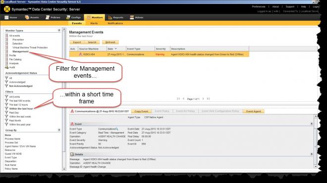

Before we can configure an appropriate alert, it is important to be able to identify the actual conditions that trigger the event.  To do that, we will look at the details of the event that is generated by the agent going offline. To do that we will need to force an event generation.  Take what ever steps are necessary to take the test machine offline.  Allow the appropriate amount of time to elapse for an event to be generated.  Review the agent health settings to determine the timeout settings for agent health.  Once the timeout value has been exceeded, you will see a management event returned to the console and displayed in the Events view.
Examine the details of the event to get clues on how to construct the alert.

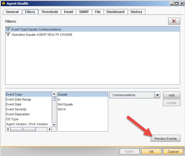

It is important to capture enough information to be able to narrowly configure the alert filters. In the above example we will want to take advantage of the two entries in the Event Details highlighted in yellow.
Construct the filters as shown.  Note: these filters are exactly as shown in the event details.  Next, use the Preview Events button to ensure that the correct events will trigger the alert.
Finally, configure the remainder of the alert settings (email, SNMP, or flat file) according to your needs.
