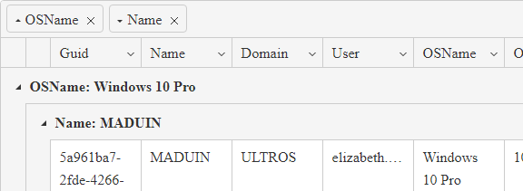

I was asked by a colleague to help find a way to provide grouping functionality within the grid component in Workflow.  Using the Angular options, this worked for him; however, there was no way to have the grid load with initial groupings (as far as we could tell).  After a bit of trial, error, and effort, I found a way to preload the groupings in the Angular grid.

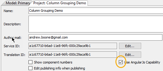

At the project's top level options, select Use Angular Js Capability.

setTimeout(function() {$('#TestGrid').data("kendo-grid").dataSource.group({field: "OSName"});}, 100);
The setTimeout delay is used because the kendo Angular component takes just a tiny moment to render, meaning that we need to delay our script long enough to allow the grid to complete. Otherwise, the script we run will not find the target dataSource. Depending on the data displayed in the grid, the delay may need adjustment to suit. The 100 value in the script above is the delay, in milliseconds.
The colleague for whom I worked on this solution needed multiple initial groupings.  The code was then adjusted to force an array of groupings, as such:
setTimeout(function() {$('#TestGrid').data("kendo-grid").dataSource.group([{field: "OSName"},{field: "OSVersion"}]);}, 100);
Note the square brackets added in to indicate an array.
If pre-sorting on those groupings is desired, add a few directionals in:
setTimeout(function() {$('#TestGrid').data("kendo-grid").dataSource.group([{field: "OSName", dir: "asc"},{field: "OSVersion", dir: "desc"}]);}, 100);
asc and desc being 0->9, A->Z and 9->0, Z->A, respectively.

That's actually why I amended the article with my comment; the colleague for whom I created the initial fix was attempting to use a Subdialog with the Angular features enabled, and it would not open.
The problem seems to be ultimately with the Angular feature being enabled for the Subdialog component. The secondary problem here is that when you attempt to clear that checkbox, it will not remain cleared. It seems as though if Angular is enabled at a project-level, it's enabled for everything.
