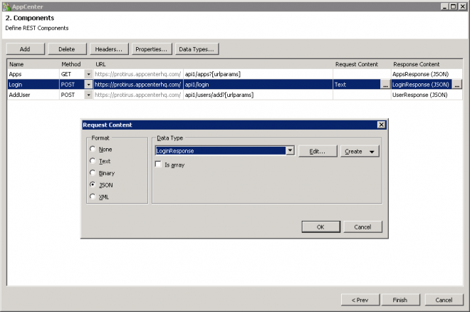

    I've checked back in an old project and you can set the Request Content to JSON.
    So you could use a Single Value mapping, pass the values you need to a DT then pass that to the REST Generator.
    Do you have an example of what you are wanting to achieve?

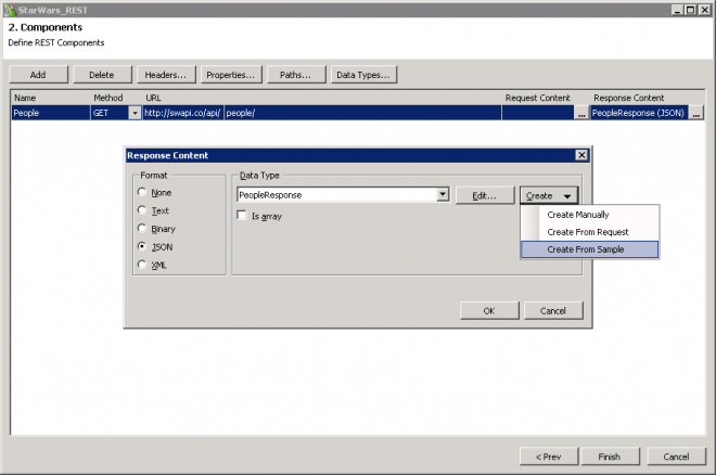

    https://www-secure.symantec.com/connect/articles/using-rest-generator-response-content-workflow-76
    They added the option to "Create From Sample"
    That would make the DT for you, then you can read a file using scripting:
