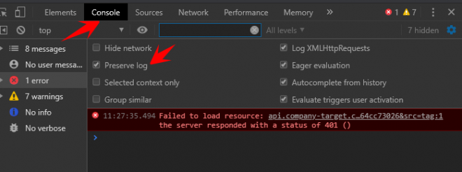

    I have enabled F12 + console in my browser and what I got:
    Maybe I missed some steps when I installed VIP app for ADFS?

    You can see from the error invalid user ID. Check that the user exists in your VIP Manager account.
    If the user ID does exist, ensure that the Enable enterprise login ID mapping is set to NO in your VIP Manager settings. This setting is not required for the Enterprise Gateway.
  • 7.  RE: ADFS 4.0 (Windows Server 2016) and Symantec VIP
    Posted 02-11-2020 07:16 AM
    Thanks, after the setting "Enable enterprise login ID mapping" was enabled the push was sent to my cell phone. So, it is working fine now.
