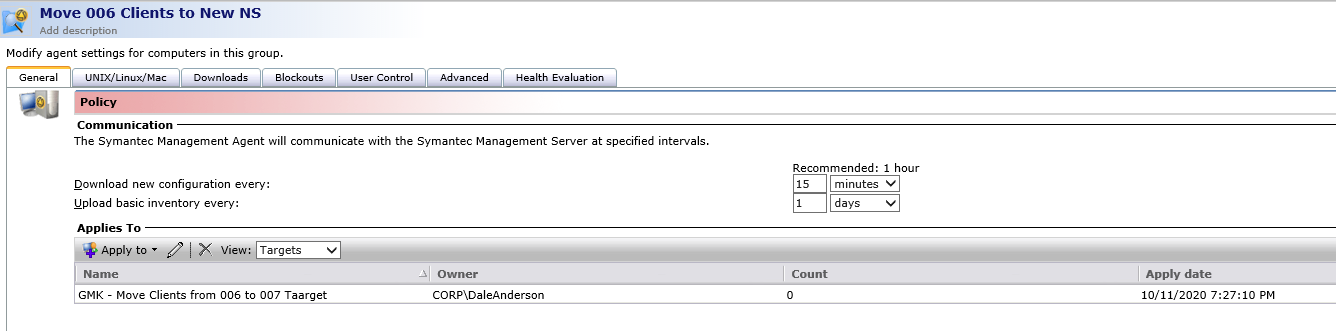

    Move 006 clients to new ns
    I have this turned on now with in the advance tab I selected the communication profile for the new server.
