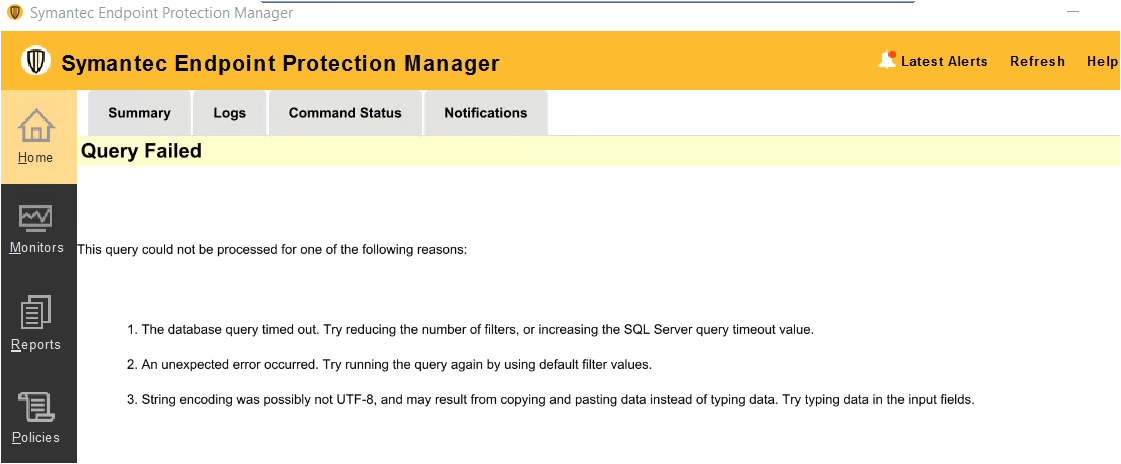

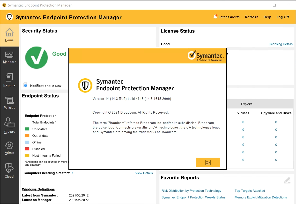

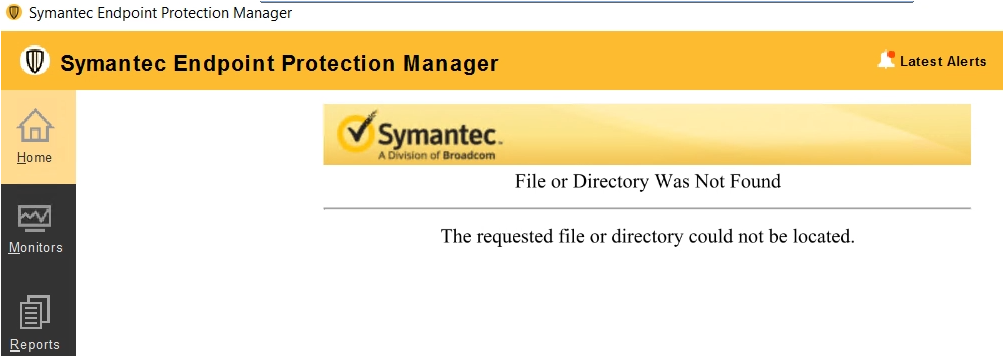

    Hi, so I have upgraded the SEPM from SEP14.3 MP1 which was working fine to SEP14.3 RU2. The upgrade went through successfully. However when I log in, the Home page looks fine for 4 seconds then a Query Failed message pops up. Above the Query failed message are the following tabs "Summary, Logs, Command Status and Notifications" (This looks like the monitors tab). Is there any one else who have seen, or experienced these issues? See screenshots below:
    After signing in.
    4 seconds later
    After clicking "Refresh"

    Just tried an upgrade to 14.3 RU2 on our SEPM 14.3 RU1 MP1.  Getting blank pages on 'Home', 'Monitors', and 'Reports'.  Doing a refresh brings up the 'File or Directory Was Not Found', same as the screen shot from the Original Poster.
    Apache Reporting.log is showing these type of lines:
    2021-06-04 15:41:51 INFO:Login start
    2021-06-04 15:41:52 ERROR:<br>QUERY: EXEC SEM_GET_GUI_PARAMETERS<br>EXCEPTION: com_exception: <b>Source:</b> Microsoft OLE DB Provider for ODBC Drivers<br/><b>Description:</b> [Microsoft][SQL Server Native Client 11.0][SQL Server]Could not find stored procedure 'SEM_GET_GUI_PARAMETERS'. in C:\Program Files (x86)\Symantec\Symantec Endpoint Protection Manager\Php\Include\Common\ado.php:587

    The error we are focusing on currently is -
    [Microsoft][ODBC Driver 17 for SQL Server][SQL Server]Cannot resolve the collation conflict between "SQL_Latin1_General_CP1_CI_AS" and "Latin1_General_CI_AS" in the equal to operation. in E:\Program Files (x86)\Symantec\Symantec Endpoint Protection Manager\Php\Include\Common\ado.php:587
    The symptom is SEPM homepage now loading.
