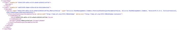

If I manually create the job and add the condition, the xml does not reference any <conditionRules> anywhere. I believe the xml is parsed and then the internal method creates the required.
If I inspect the manually created job there is a reference to a Property Name:
I have logged a support case to ask for the documentation to be updated, but the standard support response to ASDK is not supported and send the link to the asdk documents. If someone from PM team can confirm the steps for a basic example or give insight into the <conditionRules> xml that might be a help but no luck with support as yet.
Rufus Swart's profile image
Rufus Swart
the screenshot isn't clear:
<inputMap>
<input nodeGuid="4f641359-a85c-4133-a9a8-b382621c870d">
<params/>
</input>
<input nodeGuid="ad5f34f8-9de6-425b-b51d-062c5d6c63a2">
<params>
<param name="4f641359-a85c-4133-a9a8-b382621c870d_@ReturnValue" type="Altiris.TaskManagement.Common.PreviousTaskOutputParameterValue, Altiris.TaskManagement.Common, Version=8.0.0.0, Culture=neutral, PublicKeyToken=99b1e4cc0d03f223">
<PreviousTaskOutputParameterValue xmlns:xsd="http://www.w3.org/2001/XMLSchema" xmlns:xsi="http://www.w3.org/2001/XMLSchema-instance">
<JobNodeGuid>
<Guid>4f641359-a85c-4133-a9a8-b382621c870d</Guid>
</JobNodeGuid>
<PropertyName>@ReturnValue</PropertyName>
</PreviousTaskOutputParameterValue>
</param>
</params>
</input>
</inputMap>​
