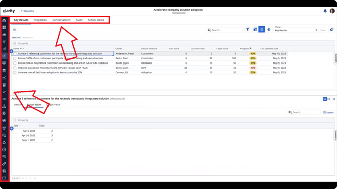

Suman Pramanik's profile image
Broadcom Employee Suman Pramanik
HI Marc
Welcome to Clarity, the menu are on the left  and the top are called modules which you can configure using blueprint. Here is the documentation on blueprint and you can also review the section Clarity: First Time Login Experience

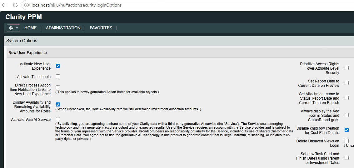

Marc R8O2dGhl's profile image
Marc R8O2dGhl
Hello Suman,
thank yu for the support. But Ii seems, I'm looking at the very wrong location.!?

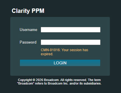

My logon mask:

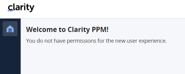

My page:

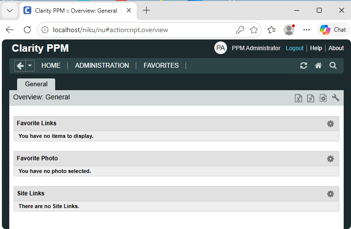

And all examples from the documentations:
Hi Marc
Since you have logged into the Classic PPM, there are few configuration needed in order to navigate to Clarity MUX . Here are the list of things to be done

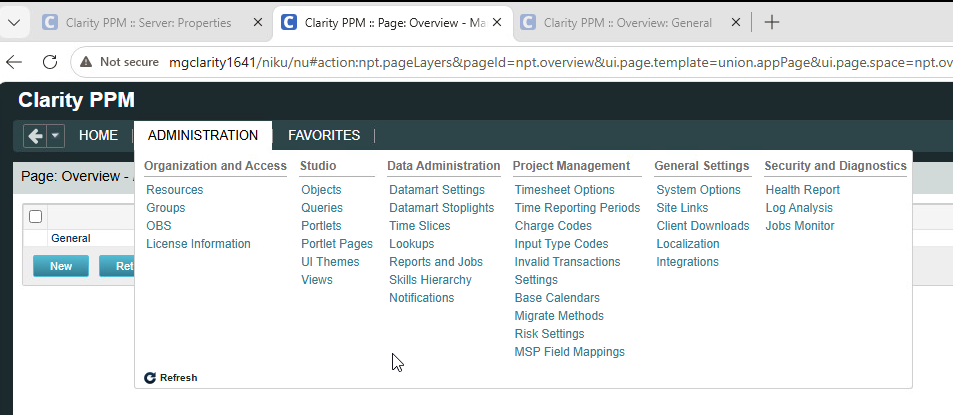

  • Provide your user with all the rights by Navigating to Administration --> Organization and Access --> Resources
  • Search for your resource and under sub menu Resource Access Rights --> Global and grant all

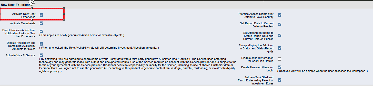

  • Now navigate to Administration --> System Options --> New User Experience --> Check Activate New User Experience
Above information is also documented under section activate Modern UX
Also there are two trainings which can help you and you can register using this link
  • Clarity 101
  • Get Started with Clarity
Let me know if you need any additional information
Marc R8O2dGhl

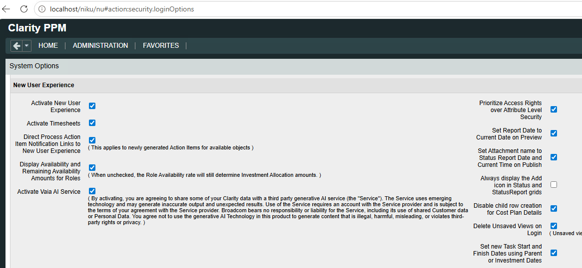

I reinstalled all the System
granted all possible user rights
sat/checked the new user experience
or
stoped the Services
cleared the browser Cache
restarted the Services
went back to http://localhost/niku/
..and everything Looks as bebore. 😢
Now you will need to navigate to /PM instead of /niku to see the MUX and also the necessary rights.
Marc R8O2dGhl
It seems to work fine, now.
Thank you very much for the support!
