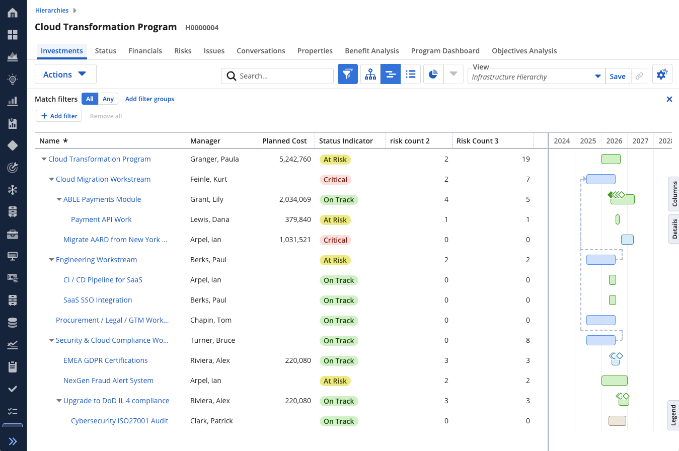

Ming Cheung's profile image
Broadcom Employee Ming Cheung  Best Answer
There is a way you can do the roll up using our OOTB hierarchies.  The challenge is Aggregated Calculated Attributes are not available in Hierarchies but calculated attributes are.
Here's what I did:
  1. Create the Aggregated Calculated Attribute on the Investment Object (I usually count the unique identifier).  This will give you the count of risks on your investment.
  2. Create a second, calculated attribute, using the attribute created in Step 1 and multiply it by 1 (or add 0, if you like).  This will return the count of risks again, but this time as a simple calculated attribute.
  3. Create an API IDs for both attributes
  4. Go to a Hierarchy --> Investments Module.  Select the View Options and click Manage Metrics.  The new metric created is based on the previously created Calculated Risk Count (the Aggregated Version does not appear in the list) with the scope "Self and Children"
  5. Below is the result: Risk Count 2 is the Calculated attribute (where Risk Count was the Aggregated Calculated) and Risk Count 3 is the Hierarchical Metric created in Step 4.
This was done in Release 16.4.2 which also supports scheduling of hierarchy investments based on the Parent attribute.
