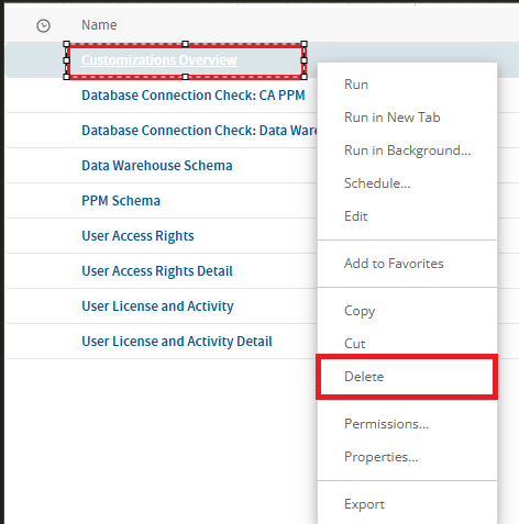

If you are the administrator of the system you can navigate to Advance Reporting --> Search for the report with the name and right click to delete the report and its dependencies.

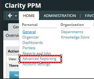

  • Navigate to Reports tab and you will see details about Jaspersoft URL and Org ID are populated
  • Now you can login to Clarity APP and Navigate to Advance reporting (see image below) you will see an app loads up and thats Jaspersoft.  Here is the detailed documentation Advanced Reporting with Jaspersoft
