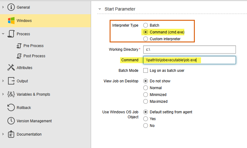

I am doing the following.
The UC4 windows agent server where the environment variable previously defined was removed and the server restarted to ensure the variable was removed from the environment.
Windows job -
  1. Windows job is defined as 'Command', with external app executable path in 'Command' window.

Ok, then my first question is: why are you using the setting of 'Interpreter Type = Command (cmd.exe)' on the Attributes tab?
It sounds like you're clearly writing a multi-line batch file here, so wouldn't 'Batch' be the appropriate choice to use here?  You already indicated it displays the script var values correctly.  (In my shop, I don't think we ever use the 'Command' setting -- we just use the 'Batch' setting as our default.)

I am using the 'Interpreter Type - Command' because the job is a CMD job that is actually running on remove system/application.
We execute currently execute these jobs with server environment variables set, the job uses those variables during execution.  I/we are trying to define and set a value to a system environment variable on the fly or per job in essence.

Well, I can't confidently speak to using the "command (cmd.exe)" config, as we never really use that in-house, but couldn't you configure it as a Batch job, and then just use a process tab like this?
@SET &ENV_VARIABLE#=&ENV_VAR_VALUE#
\\path\to\jobexecutable\job.exe
