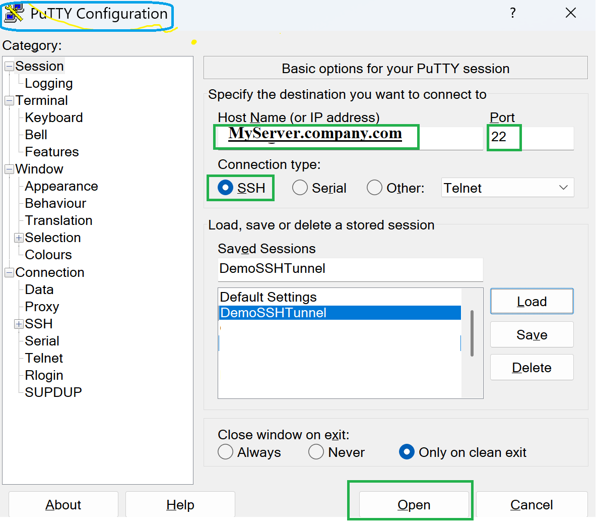

To begin troubleshooting, please verify that the client and server machines can connect via SSH protocol. You can do this by using an SSH client such as Putty on the client machine to connect to the server.
Please refer to the Putty configuration steps below:
- Enter the Server name/IP address.
- Select "SSH" as the Connection Type.
- Click the "Open" button.
If SSH protocol is enabled on the server side, a terminal window should open and prompt for server credentials.
Please let us know your feedback how it goes in your environment.
