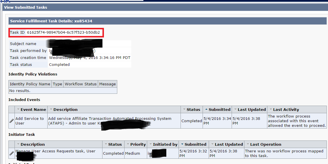

View submitted tasks is too technical for end-user to consume... This has come up many times before.

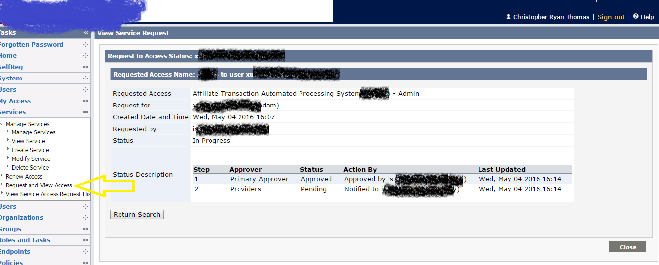

But here's a simplified view of the actual service request screen (below), it's listed within the services category that doesn't require access to view submitted tasks screen (above)
The crux of the issue is the disconnect between end user vs. service desk personnel or system managers roles within the UI.  A simplified interface is needed to display service requests status (above), searchable by unique id of the service and mutually exclusive to the view submitted tasks section, within the UI.
submitted task id is too complicated, it is a time consuming support nightmare for end users and help desk staff because all the screens are too technical.
Currently Identity manager doesn't provide human readable tracking numbers for service requests, making supporting end users cumbersome because they have no 8 digit service request tracking number.

Linking service request screens to view submitted tasks, for service fulfillment task, will provide  a holistic understanding of  the entire submission and the state all things tied to it within the database, but a simplified tracking ID (unique_name) can now be utilized to track the request and link back to details about the task, if necessary.  Without this linkage documented within a report, it will be impossible for  system managers to link service fulfillment tasks with the actual services requested, via the IdM UI, without looking at the database. The only way to correlate this linkage currently is via the identity manager db object store, using the below query, to get the unique service requests tied to the task id;
(Replace TASKSESSIONID with the service fulfillment tasksessionid to discover the service’s unique_name)
Select UNIQUE_NAME, TAG from [DB].[dbo].[FWSERVICE] where FRIENDLYNAME like '%' + (SELECT right((SELECT description FROM [DB].[dbo].[tasksession12_5] where tasksessionid='TASKSESSIONID’),CHARINDEX(',',(SELECT description FROM [DB].[dbo].[tasksession12_5] where tasksessionid='TASKSESSIONID’))-1)) + '%'
**above query demonstrates linkage between the task submitted within MyAccess and the actual unique service / application request, enabling access to all the particulars about the request, including lah entered during the service request.

As you can see in that screen shot, there's no unique identifier or tracking number provided. There's no linkage to the service fullfillment task which initiated the service request either and has all the workflow details within it. It's impossible to determine from that screen what task was submitted at what time which resulted in that particular service request and that's the problem.
