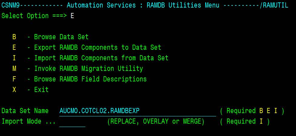

    1. In your NetMaster region, go to /RAMUTIL. Select option E to export and provide a pre-allocated data set name. The dataset should be a FB sequential data set with LRECL of at least 80 bytes and large enough to hold the export – you may have to experiment with the size depending on your system image and the number of resources. I’d maybe start with 10 cyls and secondaries, probably overkill, and then see how much was used and then trim it down from there if necessary:

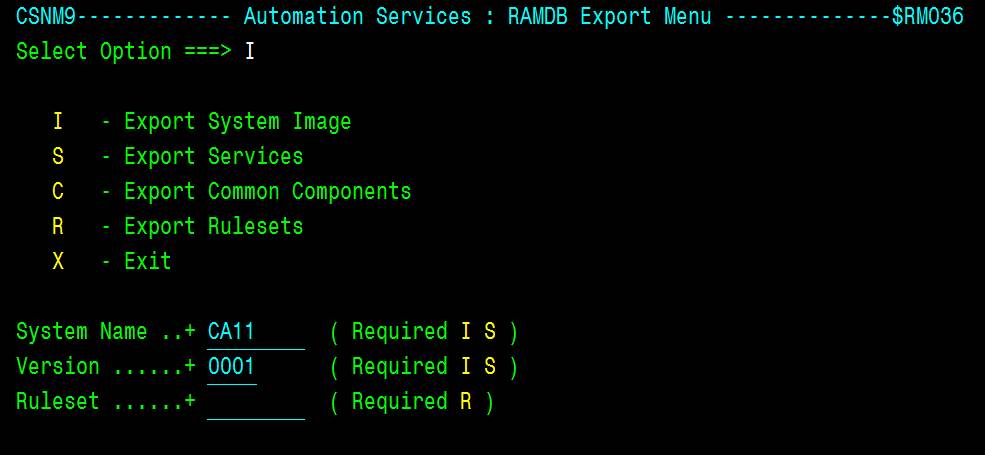

    2. Next select option I to export your system image and enter your image system name and version:

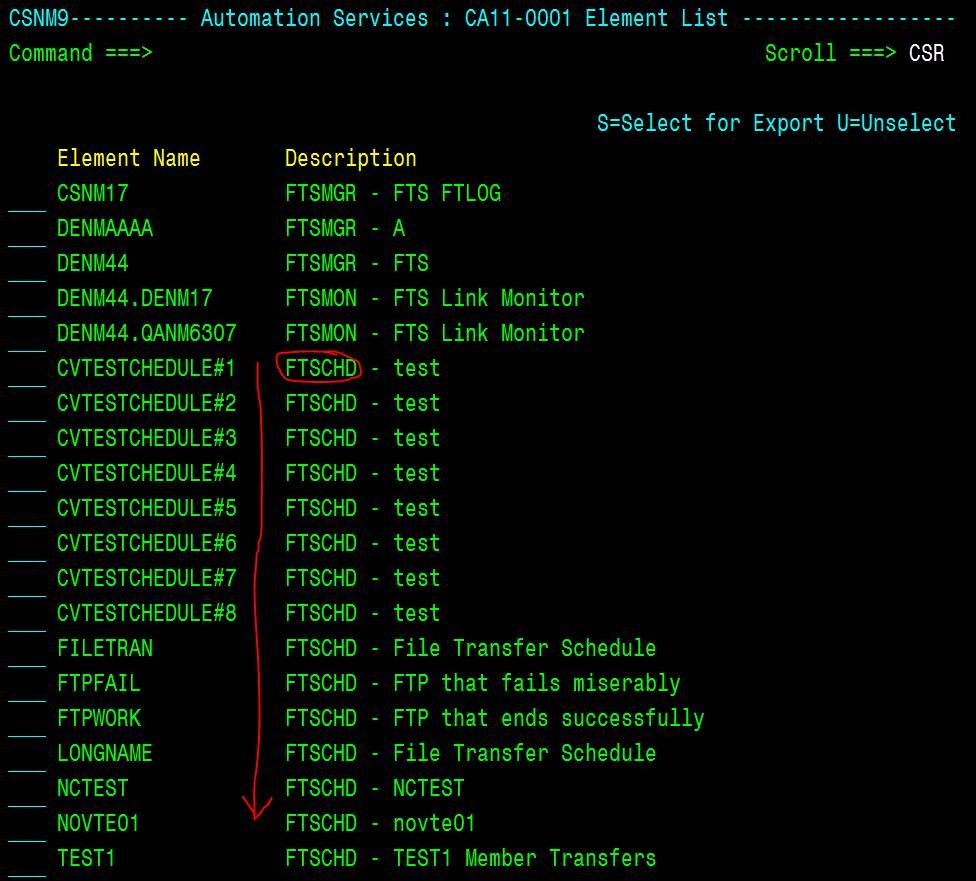

    3. Now you will be presented with a list of elements to export from the image. You can either hit F4 to select everything, or you can page down until you see the FTSCHD entries and select only those. With 400 -500 in your environment, I’d just select everything rather than trying to select all those schedules individually:

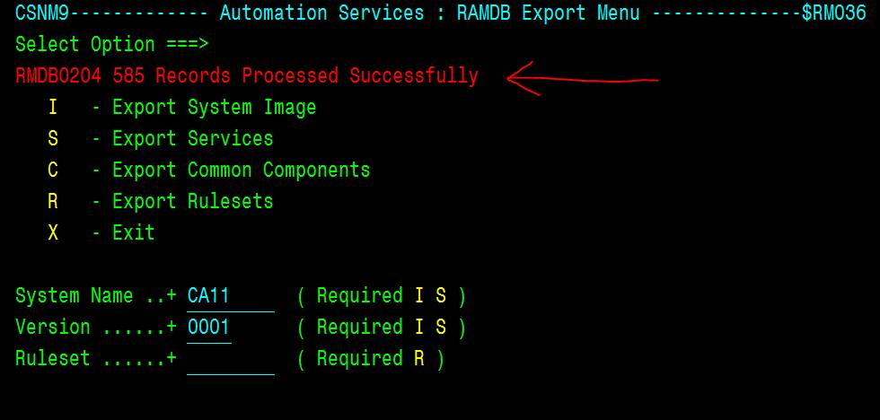

    4. Once you have made your selections, hit F6 to export:
