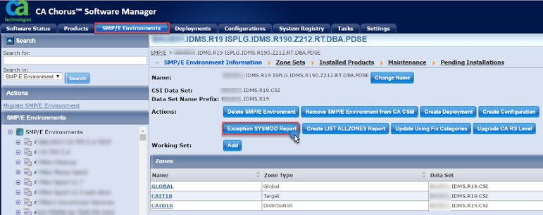

    - Click the SMP/E Environments tab
    - Locate the SMP/E environment that you want and cllck the “Exception SYSMOD Report” button

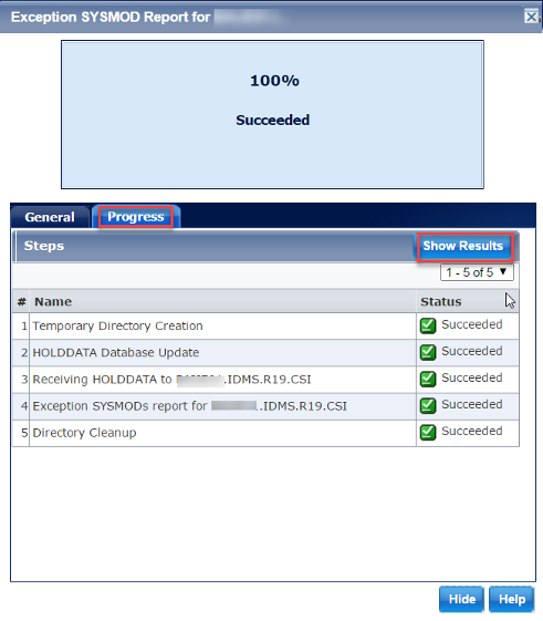

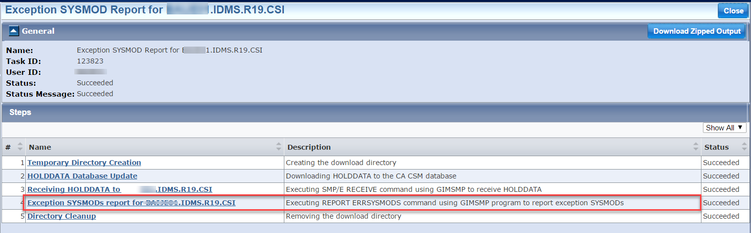

    When the task completes, click the Progress Tab and then click Show Results
    Select  "Exception SYSMODs report"

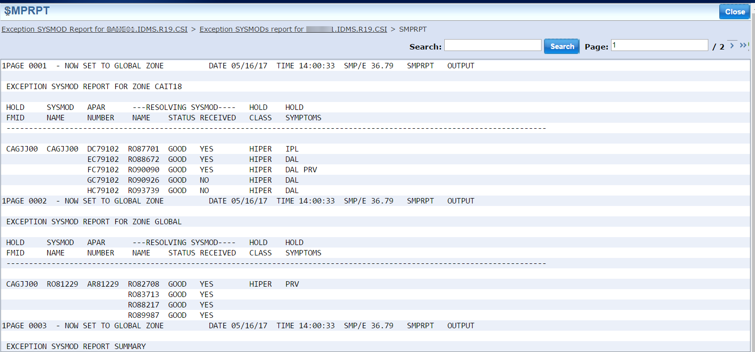

    To the right of the output name SMPRPT click the ACTIONs button where you can review, and optionally
    download the report.
    SAMPLE REPORT:
