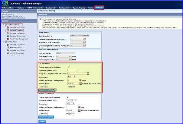

    We have our 'CA RS' scheduled for automatic download, how can I immediately download the latest CA RS without having to wait for the scheduled download?
    Answer:
    To immediately download the latest CA RS level into your Software Catalog:
    - Go to the 'Settings Tab' and under 'System Settings' select 'Software Catalog'.
    - In the "CA RS Settings' section, click the 'UPDATE IMMEDIATELY' button.
    Otherwise, in this same 'CA RS Settings' section you can see the schedule for when it will automatically download the
    latest CA RS level.
