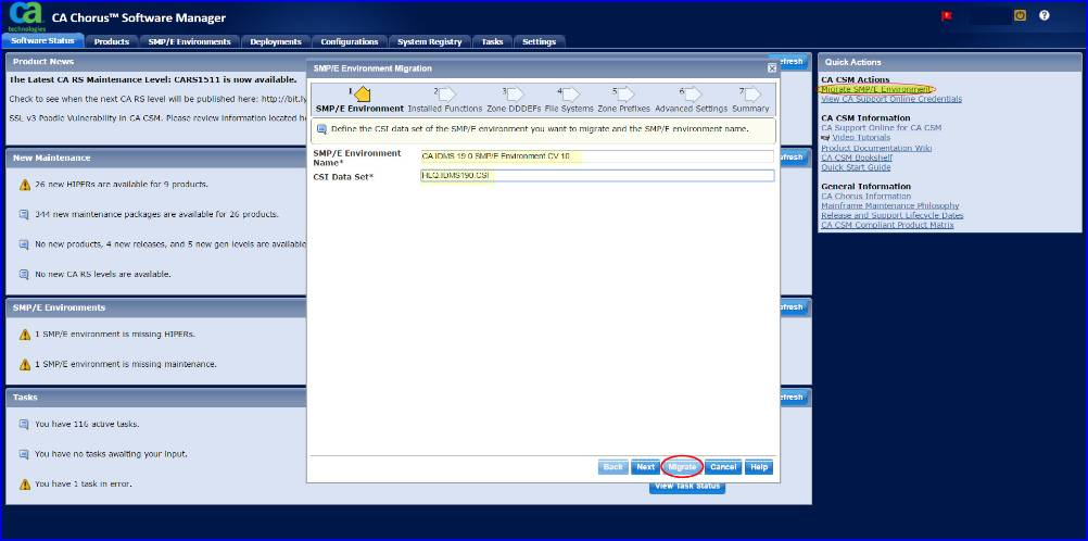

    (1). If you have not already done so, Migrate the CA CSM CSI into CSM.
    - From the Software Status Tab, on the left under CA CSM ACTIONS, click Migrate SMP/E Environment
    - Specify the SMP/E Environment name and your CA CSM CSI dataset name and click MIGRATE.

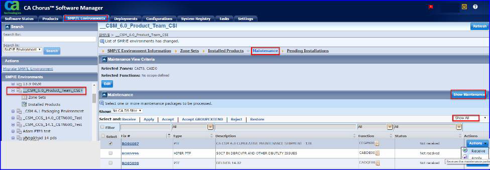

    3. From the SMP/E Environments Tab, select your CA CSM CSI and click MAINTENANCE.
    4. Review and APPLY the desired maintenance.

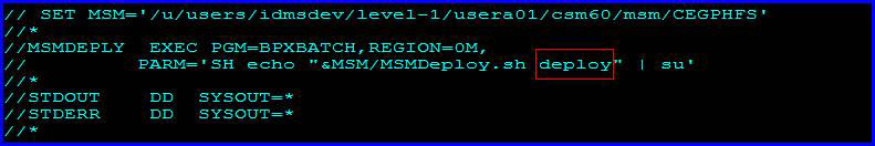

    6. Deploy the maintenance for CA CSM to the CA CSM run-time libraries and USS paths
        - Customize the RT.JCL(MSMDEPLY) job and specify deploy specified for arg1.
    7. Submit the job.
