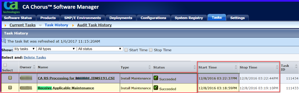

    Question:
    Is there a report of what PTFs were RECEIVED during the execution of an UPGRADE CA RS task?
    Answer:
    Yes, in the RECEIVE task output the SMPOUT report shows the PTF numbers.
    To find your RECEIVE task output in CA CSM 6.0 you have to go to the Task Tab, Task History, and find the UPGRADE CA RS task that you are interested in and there will be a second task number for the RECEIVE task with a date time stamp that is really close to the date time stamp of the UPGRADE CA RS Task.
    Example:
