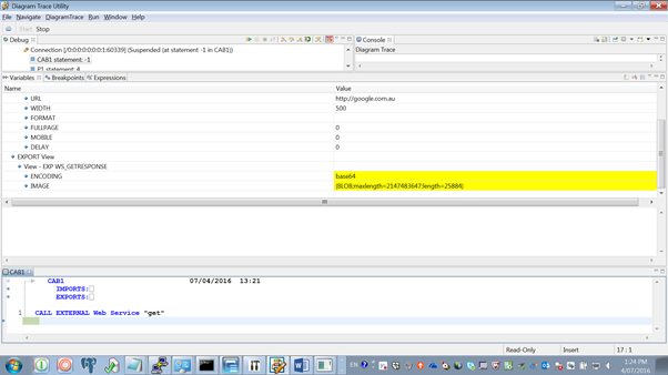

    Hello,
    I tried to recreate your problem using this free public web service wsdl: http://api.thumbnail.ws/soap?wsdl
    (Free account to get apikey:       thumbnail.ws - Website thumbnails API!)
    However I did not encounter any error
    In this case for Default Matching Gen created a TEXT attribute because the wsdl is returning xsd data type of string, but I changed it to a 2GB BLOB for testing. See attached test model.
    Recommended Gen Data Type Choices for XSD Data Types - CA Gen - 8.5 - CA Technologies Documentation
    Maybe your problem is specific to the web service returning BLOB xsd data type base64binary or hexBinary? Which one is being returned?
    Thanks
    Lynn

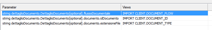

    The web service returns base64binary data (PDF file is getting transferred as binary). I have given below the export mapping and binary attribute properties.
    Given below the import mapping.
    Thanks.

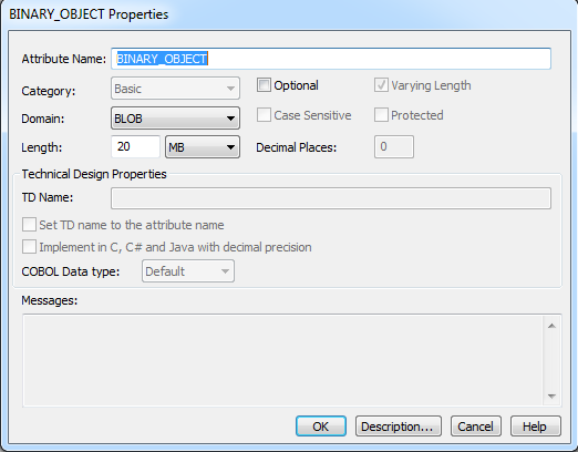

    from CA gen book - can you suggest me what the value meant here?
