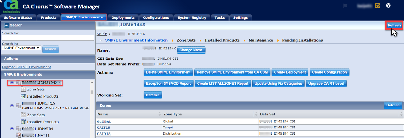

    Question:
    Is it possible to make changes to an SMP/E CSI that was created by CA CSM or migrated into CA CSM outside CA CSM? If yes, how would these changes be then recognized by CA CSM?
    Answer:
    Yes, this is possible, from the SMP/E Environment tab, click on the name of the CSI to be  resynchronized with CA CSM and then click Refresh.
