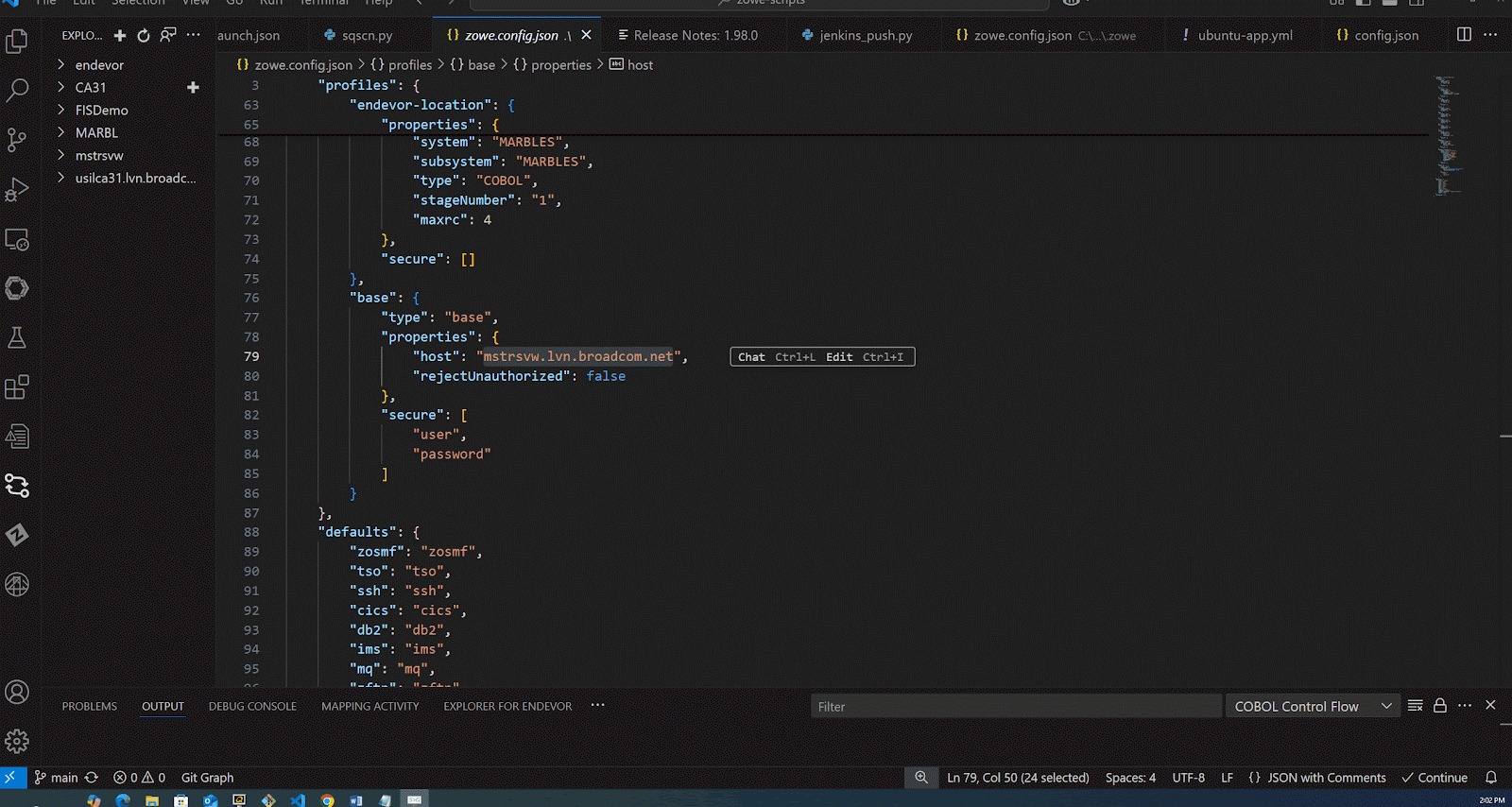

Configuring Endevor to Use Test4z
To implement this, modify your Endevor processor to invoke Test4z after compilation:
Add this step immediately after the compilation step. Optionally, introduce a toggle parameter to disable testing when needed.
For detailed implementation steps and sample source code, refer to this GitHub repository: Broadcom Automated Test Facility Using Test4Z and watch for future updates.
