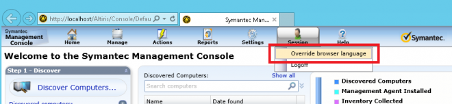

    If you have Language Packs installed on your Notification Server, the Symantec Management Console will use the browser's default language (if this language is available). However, you might sometimes need to quickly switch the console's language. For example, you switch from your local language to English for troubleshooting purposes.
    Starting from IT Management Suite version 8.1 RU1, you can select a language that you want to use in the Symantec Management Console.
    To override the browser's language, do the following:
    1. In the Symantec Management Console, on the Session menu, click Override browser language.

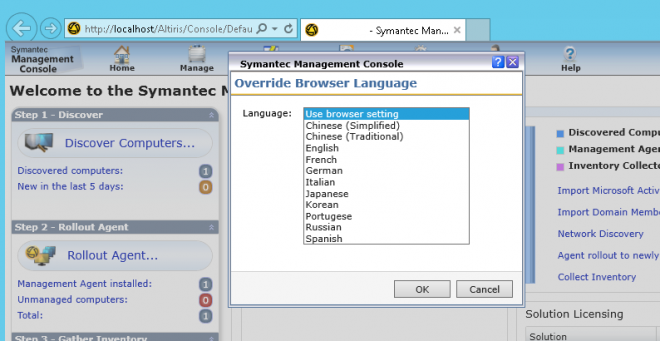

    2a. In the Override Browser Language dialog box, select the language that you want to use, and then click OK.

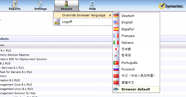

    2b. Starting from IT Management Suite 8.1 RU3, select the language that you want to use.
